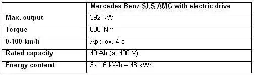

The Mercedes-Benz SLS AMGwith electric drive transforms the vision of powerful and locally emission-free super sports cars into reality thanks to an innovative drive system: powerful forwards thrust is provided by four electric motors with a combined peak output of 392 kW and a maximum torque of 880 Nm. The four electric motors are positioned near the wheels, substantially reducing the unsprung masses compared to wheel-hub motors. One transmission per axle transmits the power. This intelligent all-wheel-drive system allows dynamically optimised power transmission without any losses by means of Torque Vectoring – in other words the specifically targeted acceleration of individual wheels. In its first pilot phase, the SLS AMG with electric drive incorporates a liquid-cooled high-voltage lithium-ion battery of modular design with an energy content of 48 kWh and a capacity of 40 Ah. The 400-volt battery is charged by means of targeted recuperation during braking whilst the car is being driven.
Acceleration from zero to 100 km/h in around 4 seconds
When it comes to dynamics, the electrically driven SLS AMGdelivers an unequivocal statement: the swing-wing model accelerates from zero to 100 km/h in around 4 seconds – putting it on the same high level as the SLS AMG with a 6.3-litre V8 engine developing 420 kW/571 hp.

Key data at a glance:

The range seems to be a bit on the low side with the first generation of batteries?
SLS AMG electric drive (4 electric motors)
0-60: 4 seconds (estimated)
range: 110 miles (estimated)
Tesla Roadster (1 electric motor)
0-60: 3.9 seconds
range: 244 miles
