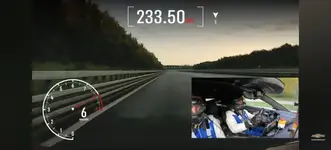

  • Corvette ZR1 boasts a GM-estimated top speed of over 215 mph on the racetrack and will dispatch the quarter mile with a GM-estimated sub-10-second time1.

  • On its first lap at the Milford Proving Ground's MRC test track, the new ZR1 clocked a faster peak speed than the production C7 ZR1.
  • Engineers clocked a sub-10-second quarter-mile time on the Corvette ZR1’s first launch.
  • All four test drivers clocked over 200 mph peak speed on their very first laps at the Nürburgring with ease.
