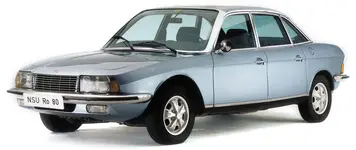

NSU's next move thrust the Wankel out into the mainstream, which in turn pushed NSU toward obsolescence. The Ro80 was a sleek sedan powered by a 115-hp twin-rotor engine that made its debut in 1967 and quickly won an International "Car of the Year" award. That was before the public started driving them, which is where the Ro80's problems started. Many early models suffered from excessive wear and some engines needed replacing within the first 30,000 miles. NSU didn't outlive the poor reputation that resulted from the problems, and Audi absorbed the failed automaker in the 1970s.

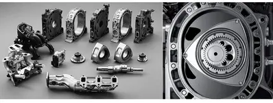

The rotary might seem complicated and alien to those who've worked with pistons their whole lives, but Wankel's design is actually much simpler than even a low-tech inline-four. There are no pistons, no connecting rods, no camshafts, no valves, no lifters, and no timing belts to break. That translates to an engine that's both smaller and lighter than a piston engine with a comparable output. Mazda's RX-8, for example, makes 232 hp and 159 lb-ft of torque from a dual-rotor engine displacing just 1.3 liters.
Crack that block open and you'll see an oval-shaped housing that holds each rotor, with the longer sides of the oval smashed in so that they're flat, creating a shape known as an epitrochoid. (An investigation at the U.S. Patent Office website reveals that Wankel tried various geometries for the engine, including an odd three-lobed housing with a square-shaped rotor.) On one of those flat sides live the intake and exhaust ports. The triangle-shaped rotor spins, beginning its four-stroke combustion cycle by drawing air and fuel in through the intake port.
From there, the rotor continues to spin until the side of the triangle is smashed against the opposite long wall of the housing. At this point, the air and fuel mixture is fully compressed and two sparkplugs in the wall ignite, spinning the rotor through the power stroke and into the exhaust cycle. Ignited fuel moves back out of the housing through an exhaust port in the same wall as the intake port.
All the while, the spinning rotor orbits a center shaft, which in exchange sends movement through the transmission and driveshaft to the wheels. Visualize the process and you'll realize that more is happening than first thought. The rotor's three-sided shape means that for each full rotation of one rotor tip, three rotations of the inner shaft have taken place.
