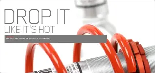

The basic construction of most coilovers is the same: The inner part of the assembly consists of a tubular shock absorber or strut body, a portion of which is threaded on the outside. A coil spring sits outboard of the shock, resting on a perch whose location is dictated by how far down the threaded body its lock nut has been dialed. When the springs and shocks are mounted separately, as is the case in some rear suspensions, the spring perch alone will be height-adjustable.
For the typical street setup there is usually a three- to four-inch range of adjustment, and the thread pitch tends to be fairly fine, allowing for very precise alterations. Since street coilovers are generally made for the performance-enthusiast market, most of them offer a significant drop even at their highest setting and go even lower for more dramatic effect.
