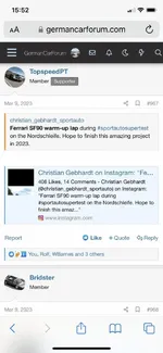

Didn't he post a week or to ago video, I think on his instagram how is he pushing SF90 towards finish line? And the laptime was showing 6:blank something?
Yes, in the SF90 tread
Yes, this video was taken in 2021 and was showing a warm up lap as per his comment...he just uploaded it this year.
You can also read his comment: "Hope to finish this amazing project in 2023"
