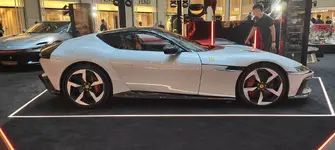

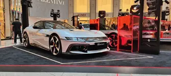

DESIGN
EXTERIOR
With the Ferrari 12Cilindri, Flavio Manzoni and the Ferrari Styling Centre design team set out to radically transform the stylistic codes of Ferrari’s previous mid-front-engined V12s. The car in fact marks a clear departure from the sculptural language that characterised the 812 Competizione, for example, instead favouring a more sophisticated language that still retains the necessary formal design rigour to achieve a sense of stylistic unity.
Clean lines dominate the car’s geometry, underscoring the volumes that make up a seamlessly interconnected whole. The ultra-clean flanks sweep back along the entire car from a dihedral section. Although retaining a signature Ferrari sensuality, the wings have been sculpted with extreme geometric precision: all the lines are the result of intersections between the volumes and a more functional approach to form has been taken that echews nostalgia. The muscular rear wing is imposing, yet also perfectly controlled geometrically. On the front wing, that muscular tension extends slightly, coming to rest along the flank and further accentuating the car’s monolithic aesthetic.
The sculpted bonnet is extremely sleek and incorporates the front wings. Removing the cut lines from the wings gives a smooth, uninterrupted surface to the muscularity of the design, lending the entire bonnet a sense of ultra-clean fluidity, interrupted only by two vents to cool the engine bay. One of the objectives of the Ferrari 12Cilindri was to explore design languages only tangentially related to the car world. The front has thus lost certain signature elements, such as the elongated form of the headlights and the traditional grille shape, in favour of geometries and intersections innate to the car’s design. The headlights are integrated into a single wraparound band from which the DRLs emerge like blades.

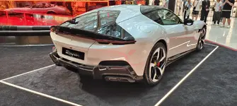

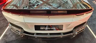

A similar approach has been taken with the rear architecture: once again, rigour is the order of the day with the shape obtained by the subtraction of volume. Consistent with the front of the car the taillights are set into a blade that traverses the entire, concave rear section and also provides what is possibly the Ferrari 12Cilindri’s real signature theme, demonstrating once again how cleverly the Ferrari Styling Centre’s designers are able to meld technical and functional demands with beauty.
Instead of adopting a rear spoiler, the designers have used two active flaps integrated with the rear screen, creating a signature delta theme. The overall perception is of a seamless whole, creating the idea of a very high-tech form. The development of this concept allowed the designers to treat the Ferrari 12Cilindri’s cabin in a new way, tracing the frame of the surface in body colour to echo the rear screen theme and integrate organically with the rest of the cabin which itself is characterised by a black screen effect.
The tail section ends in a very clean, monolithic volume in body colour as well. The lower section – in black or carbon fibre – is characterised by the prominent diffuser keels over which the body almost seems to float. This area also includes the sensors and two twin tailpipes. The latter, comprising four elements altogether, also have a completely new shape, with a metal surround to reduce the perception of their size and create a more compact look.

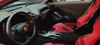

COCKPIT
The design of the Ferrari 12Cilindri’s interior sees it split into three different levels: the first, dominated by the upper part of the dash, continues around to blend into the door panel trim. Next is the central area while the third includes the footwells and seats. Each level is clearly defined, heightening the dual-cockpit effect through the colour and material combinations. These are used to create either an elegant or sporty look for the seats and other features. Ferrari’s signature luxury and performance are flanked on the Ferrari 12Cilindri by a focus on environmental sustainability: extensive use has been made of sustainable materials such as Alcantara© containing 65% recycled polyester.
The interior style takes its inspiration from the Prancing Horse’s dual-cockpit architecture. In recent years, that layout was used for the Ferrari Roma and Roma Spider as well as the Ferrari Purosangue. The Ferrari 12Cilindri’s cabin has an almost-symmetrical structure comprising two modules for driver and passenger and offering an astonishing standard of comfort and involvement in the driving experience.
The dashboard extends horizontally, a fact underscored by a clear separation between the trimmed volumes in the upper section and the technical functions in the lower section. The upper section features two distinct binnacles dedicated to the driver and passenger instrumentation and to the climate control vents. A deftly elegant colour and material change draws the eye to the two volumes separated by the body of the dash, which seem almost to float, further enhancing the feeling of lightness in this area.
The panels of the central tunnel extend outward from the dashboard geometries as if they were almost an extension of the latter. The trimmed area features a large sculptural gash emphasised by contrasting materials. The armrest is in the trimmed area of the tunnel and extends into the medallion area, revealing contrasting metallic edging that creates an elegant intersection between the volumes. The side section of the tunnel itself has been scooped out, again recreating that floating feeling. It is trimmed with luxury materials and also features a Y-shaped metal element into which the iconic gate shift has been set.
On the Ferrari 12Cilindri, quality of life on board was one of the main drivers for the development of the bespoke interior’s features. A new generously-sized tinted glass roof has been incorporated, which significantly improves the airiness of the cabin and thus the feeling of space on board, ensuring optimum thermal efficiency in both summer and winter. In terms of design, the darkened glass roof is perfectly integrated into the upper part of the cabin, giving it an elegant and refined appearance and creating continuity between the windscreen and the rear screen.
The Ferrari 12Cilindri introduces a new Human Machine Interface (HMI) comprising three displays that raise the Ferrari V12 berlinetta onboard experience to new heights. All of the main functions can be controlled from the central 10.25” touchscreen capacitive display within reach of both driver and passenger. This is flanked by a 15.6” driver display showing all of the driving and vehicle dynamics information. Lastly the passenger is always completely involved in the driving experience thanks to an 8.8” display that ensures they feel like a genuine co-driver.
The car sports the capacitive steering wheel seen on all of the latest models in the range featuring the indented buttons for ease of use. This means that command activations are more precise, instant and intuitive even in sporty driving conditions. The Ferrari 12Cilindri comes with Apple CarPlay® and Android Auto®-based mobile connectivity systems as standard, both easily controlled from the new central display. A wireless charging mat on the central tunnel (as standard) makes phone charging simple too.

The rear looks too heavy. I dont know why it gives me some Celestiq vibes. The rear.
