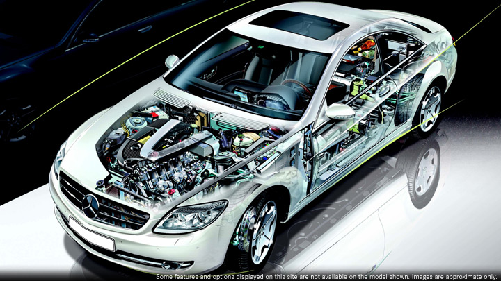

  9. Wolfgang Contributing Member
    There are other wayz to get rigidity w/o adding weight, e.g. more HSLA. But it's likely expensive, and may thus only be suitable for E/S/CL/CLK. :t-drive:
    Body structure
    A range of precision safety elements work together to protect you and your passengers in the event of a collision. All of them are encased in a rigid body structure utiltizing high-strength/low-alloy (HSLA) steel in critical areas such as the roof pillars, floor and roof crossmembers, door beams and various reinforcements throughout the body. HSLA provides greater resistance to bending and flexing than conventional steel of similar weight. Elaborate engineering of the side and roof structures helps provide excellent side-impact and roof strength even without a full B-pillar.
    Source: 'Merican Mercedes-Benz

  15. Wolfgang Contributing Member
    For first responders MB provides some info about the steels used in the CL. :t-drive:
    Source: Mercedes-Benz USA
